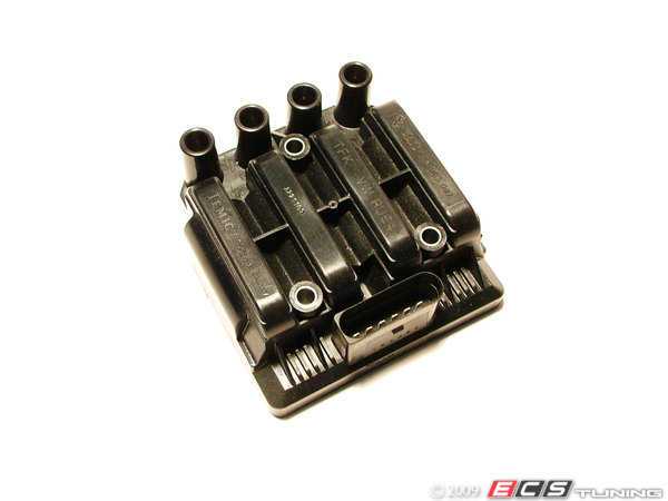

Have you checked this out?
The AEG has a different coilpack design
AVH:
AEG:
