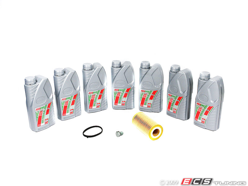

We have oil service kits available if needed that include 502 approved oil, filter and drain plug, they can be found here on the website for the 2.5L cars:
Volkswagen New Beetle 2.5L > Maintenance > Engine > Service Kits - ECS Tuning Inc
