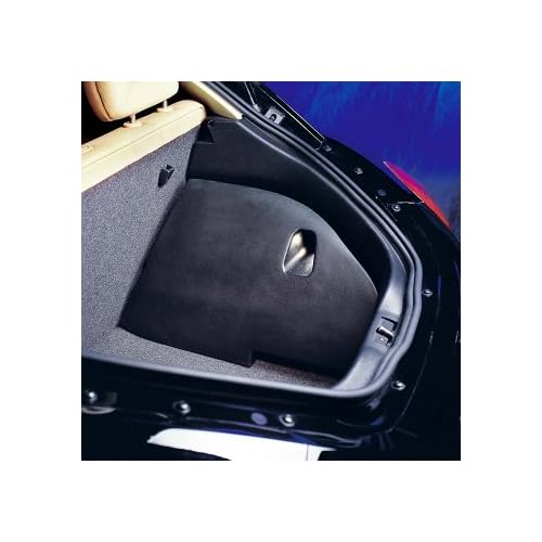

Here's the deal... I think you should get an MTX BUG10A or Bug10.. you know that new box I got for my Beetle I was going on about in my thread the other day? It's shaped for the rear of the Beetle. Now, the Bug10A box is different than mine, in that it also has a built in MTX ClassD 200 watt amplifier to support the MTX 10" subwoofer.
So in the back of your car, it looks clean and perfectly tidy...
Now, the Bug10A can go in prices from 300-500. They also make a Bug10, without the amplifier, and then you can choose your own amplifier like I did. But I was also lucky to get the box for $50, and the amp for $100 (really nice Pioneer).. and the Fosgate P2 10" for trade for something I already had.
But I would swear by these.. they sound awesome. And JDesigns has the BUG10A in his with the MTX amp and sub, and it sounds just as good.
You just missed , just over a week ago, an orger here sold one of the Bug10A's on ebay.. went for 61 bucks in the end. Sorry man :/
There (is) one of the non-amplified versions on ebay, brand new, for $270, with free shipping from a verified, excellent seller.
http://cgi.ebay.com/MTX-THUNDERFORM-...QQcmdZViewItem
That would be my choice. The other option is to have some speaker box rattling around your trunk that wasn't meant for it, or buy one of the wheel-well sub systems, but those run in the 600-700 range with the replacement floor.
The nice thing about the MTX, is that it has two rubber plugs that mount to the car, and they hold the box in place. But if you need to move it, you just tip your back-seat forwards, and the box comes free. When you are done, set the box in place, pull the seat up , and the box is once again clamped in place.
If you want to hear mine this weekend, let me know, and we can meet up to demo it
Now, the only thing to consider is this. If you get the Bug10A, it does not come with a Bass-control. Which means, since you have a stock stereo, you won't have too much control over "bass output" to the sub. You'd either have too much bass at some points or not enough at other points. If you get the Bug10, non amplified, then you could choose a nice amp like an Alpine, MTX, or Rockford Fosgate, that would also come with a "Bass Control", which is a small knob that would mount under the dash, OR, my choice , if you happen to have any little blank button-covers on the dash anywhere, pop out the cover, pop open the bass control, remove it's case, then drill a small hole in the blank-cover, install the knob, and insert the blank back into the dash. I did this for my buddies brand new Kia and it looked *sweet*. It looked like a very small factory installed knob.
