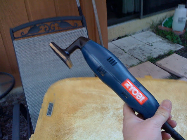

Yup...My last name is Fox
Join Date: Dec 2006
Fort Lauderdale, FL, USA
Car: 2000 GLS 1.8T (Arrow Silver) = Mine 2007 2.5 pkg.2 (Salsa Red) = Wife's
To quote Gina :
"Hand Sander" Takes it all off and does it smooth!!! I used 200 grit to get the gunk off...It takes alot of pads, but it makes life easier...MUCH!!!

vibelife's Avatar
Join Date: Dec 2006
Yes, I went to town on them :-) Many pad changes though. the key is to take your time, and do not get impatient and say (it is just a little bit here and there) I sanded it down all the way to the plastic...

GINA's Avatar
Custom User Title, go!
Baltimore, MD, USA
Car: 2008.5 Mazdaspeed3
Originally Posted by vibelife View Post
To quote Gina :
That's totally the way to do it
