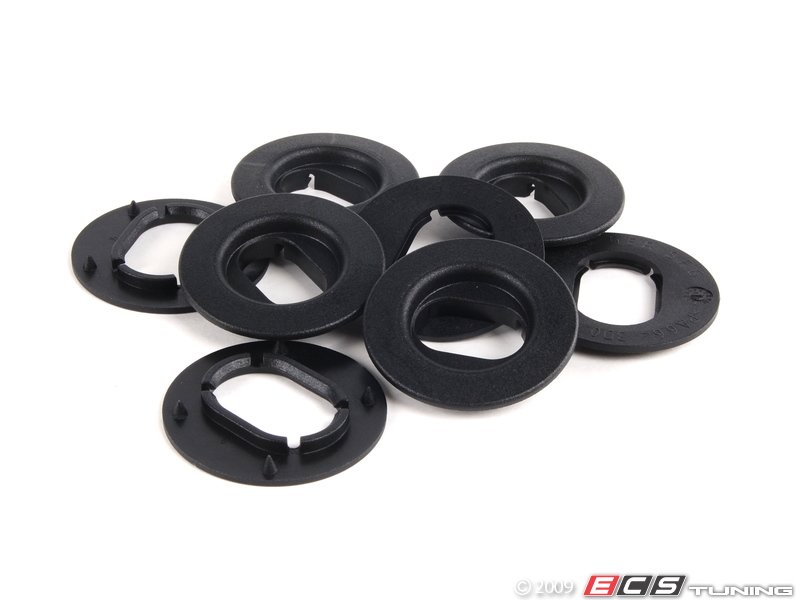

The fasteners do come as a kit, we have floor mat hardware available here on the website:
Volkswagen New Beetle 1.8T > Interior > Floor Mats > Hardware - ECS Tuning Inc
