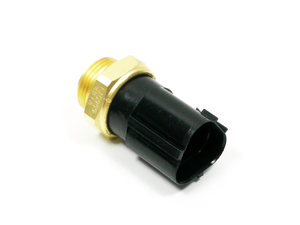

About a week ago I saw 230F on the temp gauge after a hard run and I knew I had to do something. I picked up a low-temperature fan switch. It's made by Meyle and the part number is 701959481. The stock fan switch turns the high-speed fan on at 215F and turns off at 203F. The low-temp sensor turns the high-speed fan on 200F and turns off at 188F.

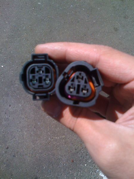

The main problem I ran into was that my car came with a triangular connector like this one:

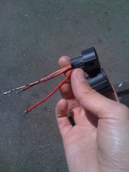

The cooler temperature sensors only come made for a square plug so obviously it isn't plug-and-play. I went to a junkyard and got a square connector and a few inches of wire for $10 and spliced it in. The connectors are almost the same and the wire colours are identical and in the same pin positions.
So after it was all back together the fans started coming on earlier and it was really nice to see the car keeping the temps under control. The FMIC causes the car to run warm most of the time but the car now only gets up to 210F in traffic and is dead-on 190F while cruising.
Awesome mod for only about $35 total!
