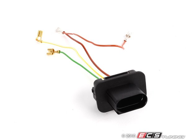

When you take out your headlights, you disconnect this from the car because its how they get power.
What is the condition of those wires? With time, the wiring eventually goes bad and if they begin to touch, they can cause shorts. You can electrical tape them or replace them if needed.
See here for the wiring harness pictured above. It isn't as expensive as you think.

I've got the same issue. New bulbs work, but the voltage is 10.5v or so constant. So I'm assuming the wires are just old/fried and might be shorting, too much current is probably blowing them.
That is the plug I need thanks for the link! The epoxy in the 2 part plug is all fried as well.
my wires look so bad previous owner cut/glued the lowlight power wire together and back apart. so i'm guessing that is my problem. I Have some plans for my lighting regardless. Is there anyway of preventing this with hids, or will this be a common issue?
